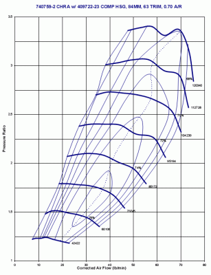

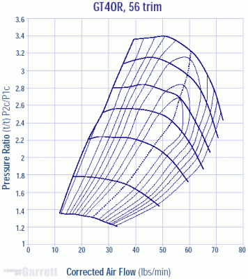

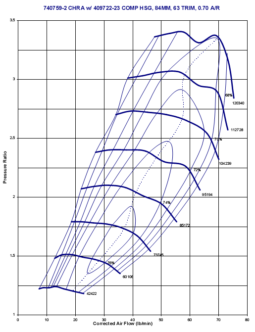

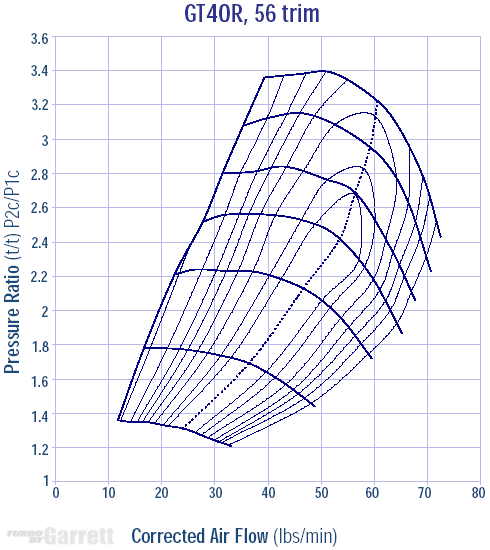

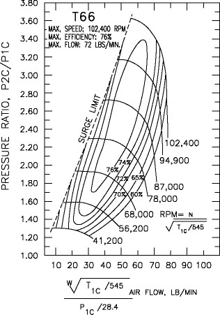

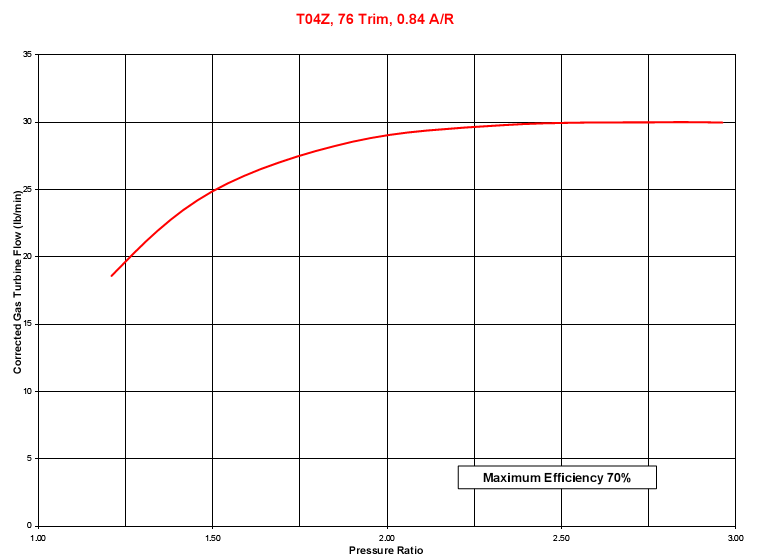

Posted: Sun Apr 29, 2007 11:25 pm
Age: 73
Posts: 3555
Joined: 7th Nov 2004
Gallery: 4 images
Power: 482 rwkw
Location: Penrith
Check out the flow maps...
To see more and more tech info check here...
http://www.turbomustangs.com/turbotech/main.htm#ar
