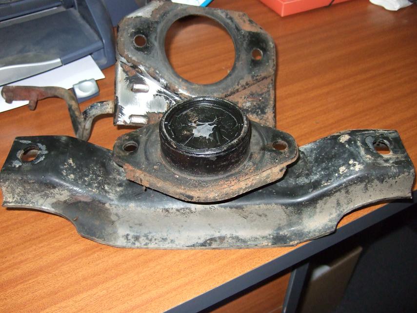

looks like this?

yeah thats the one i have. thanks though
