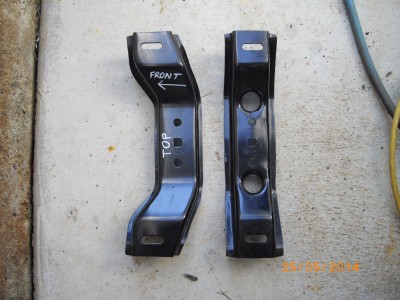

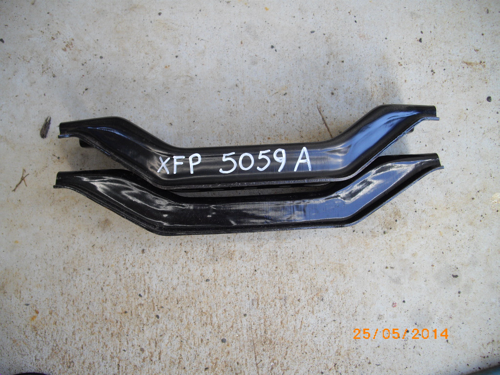

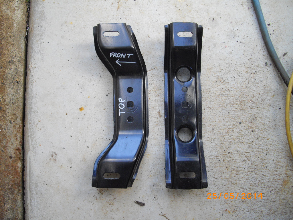

Here is the difference in the g'box xmembers...........3 sp (auto & manual) and 5 sp.
http://youtu.be/jJTh9F3Vgg0
