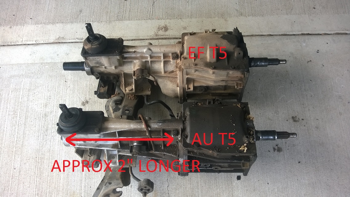

Not sure if its been put on fordmods yet but I went to put my T5 manual box form my EF XR6 into my AUII and discovered its around 2" shorter. Heres a pic.

Sorry, I read the previous posts that state this but theres the proof anyway..

I thought the Commo T5's had a really long input shaft compared to the I6 Ford ones............?????
