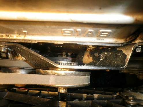

Here is 2 pictures I snapped to show where I am currently sitting, Anybody know if I'm close? Do I need to Advance or Retard 1 gear tooth?

 Post subject: Re: T5 Manual Conversion will not start
Posted: Sun Sep 25, 2011 9:22 pm
Age: 34
Posts: 4583
Joined: 30th Aug 2010
Ride: BF XR6,
Location: NEWCASTLE
So what your saying is
Put in dizzy turn crank until it lines up with no.1 spark
Mark it so I know the position
Turn Crank to TDC/Compression
Drop dizzy in and it should bottom out to the oil pump
Then fine tune.
Sounds good, just a question with the alignment of the button/needle whatever you call it. Does it have to be centred witht the no.1 spark or is it just touching as it hits 10BTDC?
Cheers, Tim.
set it right on no 1 spark plug lead, then just start the car and fine tune it with the light to where you need it and tighten the retaining bolt
