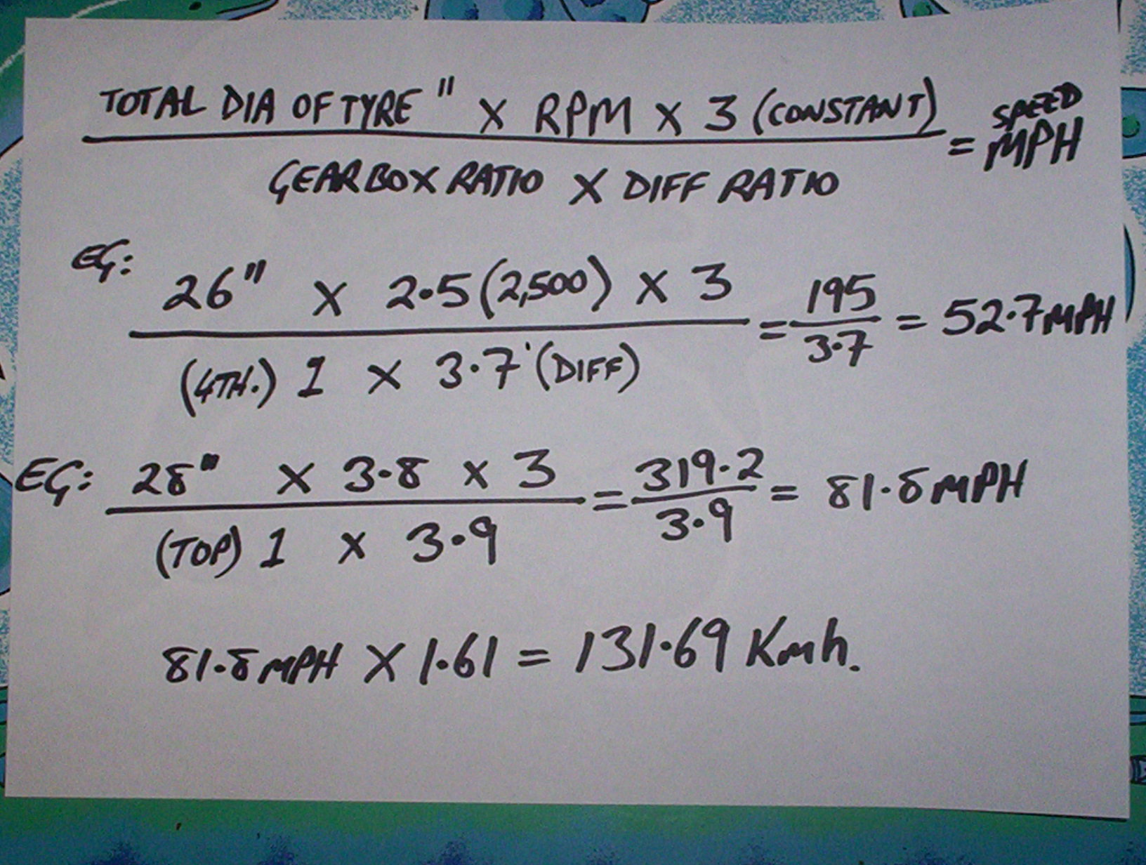

Here's a speed calc for tyres sizes versus diff ratios and g'box ratios.

same picture as in the first page of the same post!

Yes that formula does work when you muck around with that 'constant' figure until you get a baseline for your car. For example i had to change the constant from '3' to '2.86' for it to read 2100rpm @100km/h.
An easy and quick way ive found, if you want to just change diff ratios, and wanna know how many revs at 100km/h for example....
2100 rpms @100km/h with 3.23 diff at the moment but i wanna change to 3.73's
So, 2100 divided by 3.23 then multiplied by 3.73 equals 2425rpm @100km/h
Easy.
