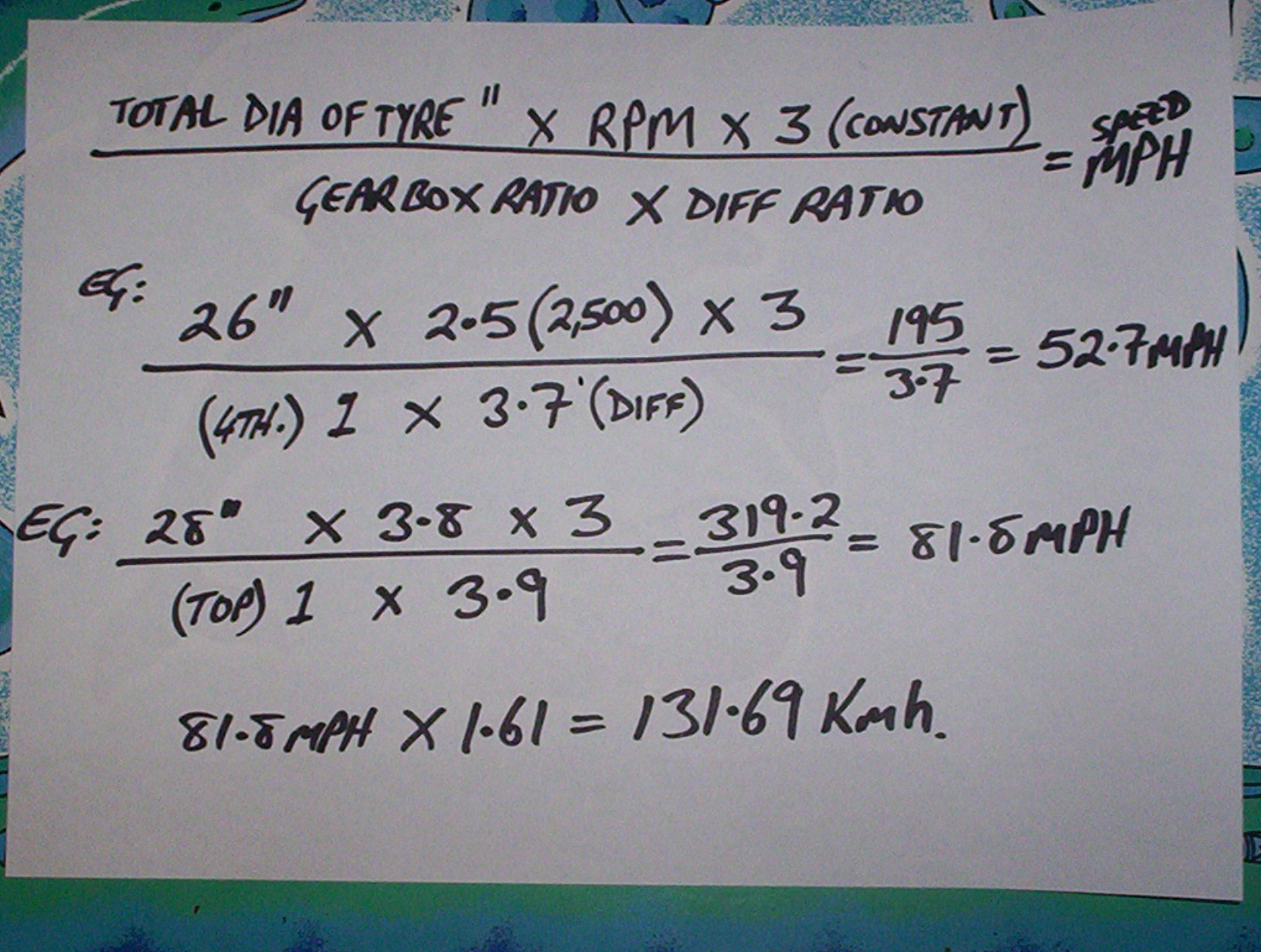

Here's a calculator that works. Just follow the formula and fill in the blanks with your details.
