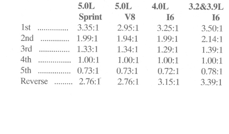

this is a list of e series t5 ratios from the factory manual..

Let the disagreeing begin, last time i showed these ratio on a fordmods forum all i heard was know it alls telling me i was wrong .SO with a quick check here is a site that backs up the ratios i stated on the EL series!
El full gear ratios listing:-
http://www.trueblueford.com/EL_Gear_Ratios.html
This is a Good TREMEC site for T56 and TKO box info. Tell ratios torque capacities and some other info and US prices:-
http://www.thedrivenman.com/KE/gm/trans ... ilder2.asp
EF XR6 Manual 271RWHP/199RWKW N/A using Stock manifold with dual plane runners still operating. EFI Hardware 6TBM to come mid year.
You were wrong, that site backs up what we were saying.
You said the XR6s had the 2.95 first, and that boxes differed between XR and non XR.
They don't.
That site saying 3.23 vs 3.25 is probably a typo, seeing as they mention the diff being 3.25.
Pretty clear it's been transposed wrong.

T50D transmission
This is for EF and EL series.
5.0L V8
2.95
1.94
1.34
1.00
0.73
Reverse 2.76
4.0L I6
3.25
1.99
1.29
1.00
0.72
Reverse 3.15

I found the E series ratios on another thread thanks to Damo
EA T5
1st: 3.50:1
2nd: 2.14:1
3rd: 1.39:1
4th: 1.00:1
5th: 0.78:1
EB2-EL T5 (6 cyl)
1st: 3.25:1
2nd: 1.99:1
3rd: 1.29:1
4th: 1.00:1
5th: 0.72:1
BA I6 T5
First 3.35:1
Second 1.92:1
Third 1.29:1
Fourth 1.00:1
Fifth 0.72:1
Reverse 3.15:1
BA Turbo T5Z
First 2.95:1
Second 1.94:1
Third 1.34:1
Fourth 1.00:1
Fifth 0.73:1
Reverse 2.76:1
