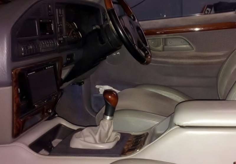

With the adjustment and height, the MGW sits well in a E-series. This is mine in neutral.

Is it really just the handle that effects the shift stroke length? Not the actual pivot in the base? I'm not understanding how the angle difference in the handle makes a shift reduction... Is each handle shorter as well?

The pivot is changed, and springs added for 2-3 shuft help. The length of the handle is just to adjust it a little more. The angle doesn't really change much except knob position.

I think the distance between the pivot and the selector ball on the bottom is what makes it a quick shift. The different handles are slightly different lengths so they can offer different throws without having to make complete different models. That's how I see it anyway.

the thing is if you actually measure the pivot point between the short shifts and the std shift its the same, the only thing short is the shift handle.
the cheap one I had in my ed fell apart, the nylon bush in the centre had cracked and fell to pieces. so I pulled the std one apart to use its nylon bush and that's where I noticed the distance between the ball on the end to the pivot point was the same..
The MGW is different. Definitely different length between pivot and ball.

I had the cheap one from usa on the ed and a b&m on my au xr8 and both have same pivot points, hence the reason I ditched them and now using the factory one with modified handle.. not to mention the nvh transferred through the billet shift was driving be nuts..lol

That's a little odd? At one point (after my cheap one sh@ itself too!) I adapted the shorter stick to the factory unit, it was obviously shorter but didn't feel as short as the chinese or the MGW. And definitely didn't feel as slick and precise.
